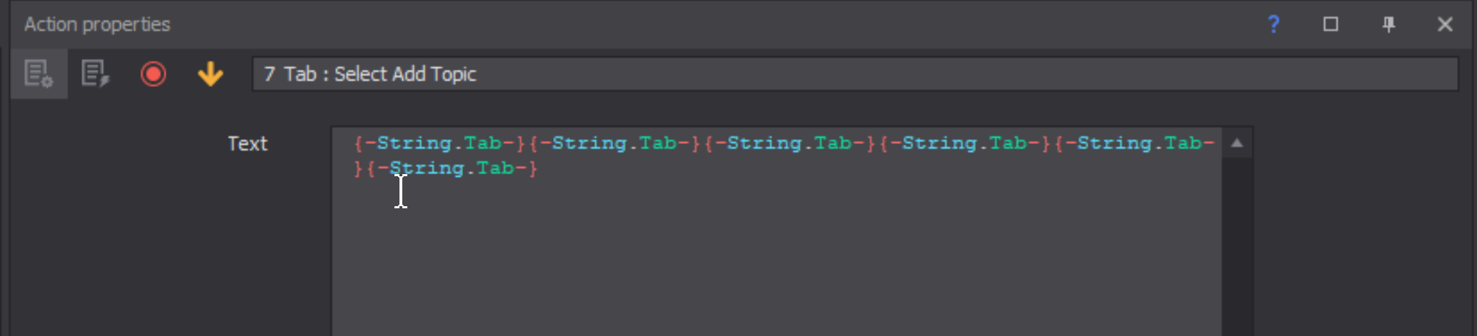

Maybe I'm thinking for a solution that would allow me to precisely target and interact with this field without relying on X/Y coordinates just to "try",)
For the moment i have to use a 7 tabulation to get to my field...
117535
and from this i copy paste 5 tag:
