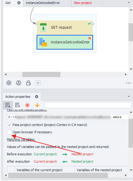

Are you sure, you've enabled this option for subproject?

Thank you Vlad for the recommendation. I'm wondering when exactly I have to check "Open browser if neccesary" in the main-project? Only when it uses no browser (project-settings "do not use a browser") and the subproject does use browser? Or are there other circumstances...
You should enable it if your subproject works with browser, but main project is non-browser.

And if I also enable it if my main project already works with browser? Any negative effects or does it make no difference?
Also if I check "Open browser if neccesary" in the main project but the sub one works without browser?

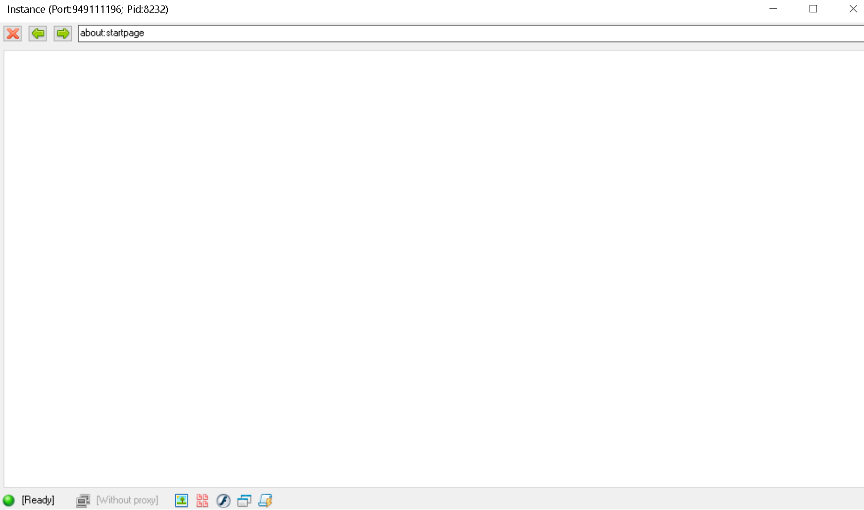

Here it is how the instance is looking in all these situations:
50232
So, this happens in both V5.40 and V7.1.1.1.0, with any kind of template, on Chrome browser, with both residential and data server proxies.
When this happens, the CPU goes to 100%. If I just terminate the threads in Zenno, I have to wait like forever for Zenno to actually kill the threads. If remove the project from Zenno and add it again, when I start it, it will start on just a few threads (like 8 from a total of 20). The best thing to do in this situation is to shut down Zenno and restart it. This way, it will work fine for like 20 minutes. then, the threads will start to hang up again. After an hour, I need to do the shut down and restart trick.

You can test newer version 5.41 - https://www.dropbox.com/sh/sepjz186mxb5hlg/AADG1C4Ip2ASmWn1H79ch1T6a?dl=0
We've worked on fixing threads hanging in zennoposter.

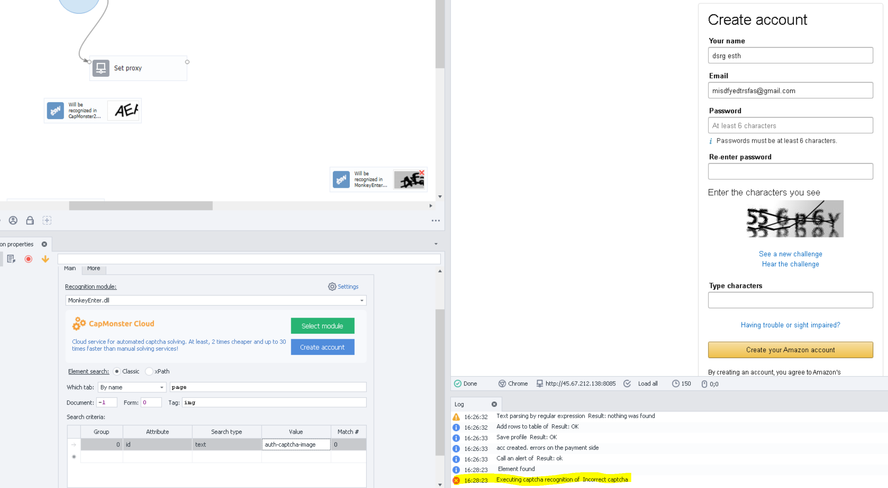

Meanwhile, I found a new (possible) bug in 7.1.1.0:
50372
It appears only when dealing with this specific type of captcha (it identifies correctly other types of captchas) and only when using Chrome. It appears instantly, when the Zenno tries to execute the captcha identification. I switched to Firefox, and Zenno identifies correctly this captcha, which is then sent to Capmonster and solved without any problem.
It doesn't seem to have issues with other types of captchas. I also tried changing the solving solution (switched from Capmonster to deathbycaptcha and anti-captcha) but it looks like it has nothing to do with the solving solution, it doesn't even work with monkeyEnter. To me, it looks like it's a Chrome issue

I don't think there is the bug. How do you create action This is captcha? Did you set it in Chrome initially?
Yeap, I've set it in Chrome initially. The template is new, created in 7.1.1.0, with Chrome browser. Only after many unsuccessful trials I decided to switch to FF and try it there.
Can you tell me where to find this captcha? I'm trying to create account on main amazon page, but don't get it.
I'm getting it on the main amazon page, too (Sign-in > Create Amzon Account) but you'll need a bad proxy. I think a public proxy would do the job. A datacenter proxy which is spammed really hard would also trigger it. I can give you a datacenter proxy but I would need your IP to tie it to the proxy list.
Ok, we'll try to deal with it.
