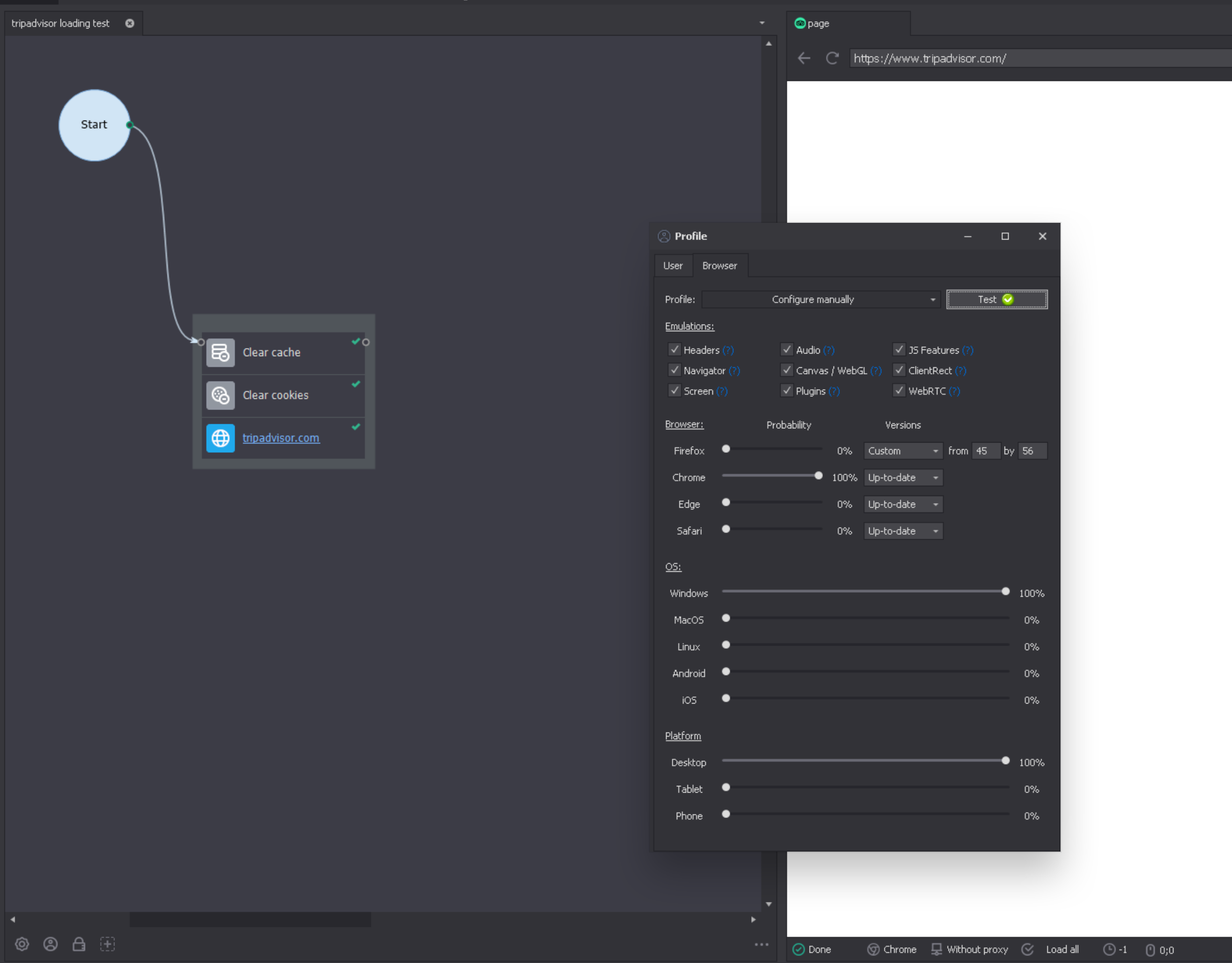

But I cannot make 7.1.2.1 load tripadvisor.com (I encountered other sites, too, with this problem...but I don't remember them because they were not important and I thought it's a proxy problem).
The thing with tripadvisor is that it is loading on FF52 but it is not loading on Chrome: tried with/ without any proxy, with/ without emulations (default profile), javascript and plugins enabled...

Is there any workaround for this?
I have a similar problem.
I cannot load tripadvisor.com on Chrome
The issue is in Accept-Language profile parameter. We wil fix it in next versions.
Curretnly, you can make it work like this:
