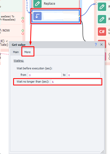

EtaLasquera
reply is extremely good for a lot of case's but i don't think that was the question you were asking
For a 'GENERAL' time out for some action blocks you need to go into the "action properties"
(double click or in the action properties windows there are sometimes a tab thats says "MORE")
99298
in all other cases the C# code is your solution

EtaLasquera
Great! I've never seen this ^^ its very usefull!
