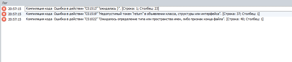

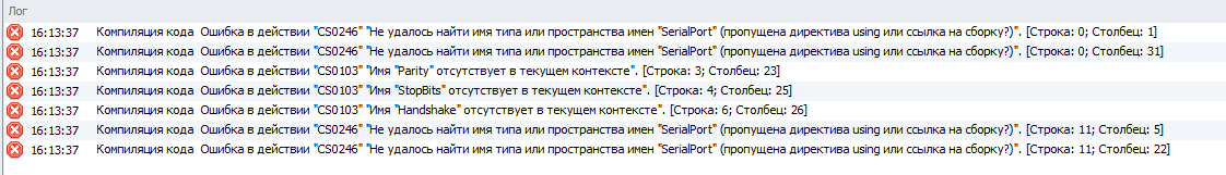

Кто нибудь подскажите плиз что не так с этим кодом
using System;
using System.IO.Ports;
class PortDataReceived
    public static void Main()
        SerialPort mySerialPort = new SerialPort("COM4");
        mySerialPort.BaudRate = 9600;
        mySerialPort.Parity = Parity.None;
        mySerialPort.StopBits = StopBits.One;
        mySerialPort.DataBits = 8;
        mySerialPort.Handshake = Handshake.None;
        mySerialPort.RtsEnable = true;
        mySerialPort.DataReceived += new SerialDataReceivedEventHandler(DataReceivedHandler);
        mySerialPort.Open();
        Console.WriteLine("AT+CFUN=1");
        Console.WriteLine();
        Console.ReadKey();
        mySerialPort.Close();
    private static void DataReceivedHandler(
                        object sender,
                        SerialDataReceivedEventArgs e)
        SerialPort sp = (SerialPort)sender;
        string indata = sp.ReadExisting();
        Console.WriteLine("Data Received:");
        Console.Write(indata);
@Tvister, чекай
mySerialPort.DataReceived += (sender, e) =>
Console.ReadKey();
Реакции: Tvister
@Tvister, чекай
Console.ReadKey();
Ошибки
