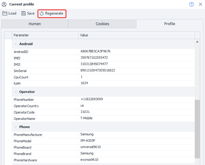

Using this function, you can generate new Android device parameters every time: phone model, IMEI, Android ID, IMSI, Sim Serial (sim-card serial number) and others. All this is generated at the same time when starting a thread in ZennoDroid. Also, you can regenerate the device parameters in ProjectMaker in the «Current profile» section‎.

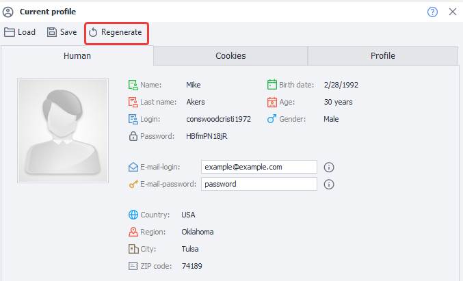

Profile generation depends on the nationality selected in the profile. For example, if USA is selected, the country code and name will be American, the phone number will start with +1, IMSI, Sim Serial will contain country and operator codes.
The phone model is related to IMEI. For example, the IMEI above corresponds to Samsung SM-A505F.

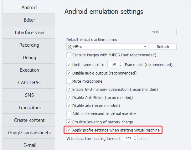

The profile is automatically applied if there is a checkmark in the settings.

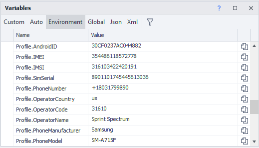

Android device parameters values in Environment Variables
Profile parameters (IMEI, Android ID, operator code, etc.) are added to the Environment Variables. Now access to the necessary data has become easier and faster.

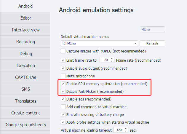

GPU Optimization and Anti-Flicker settings
We've added the ability to enable GPU Optimization and disable Anti-Flicker to reduce the load.
