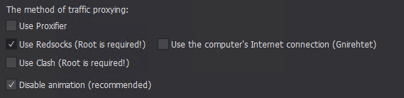

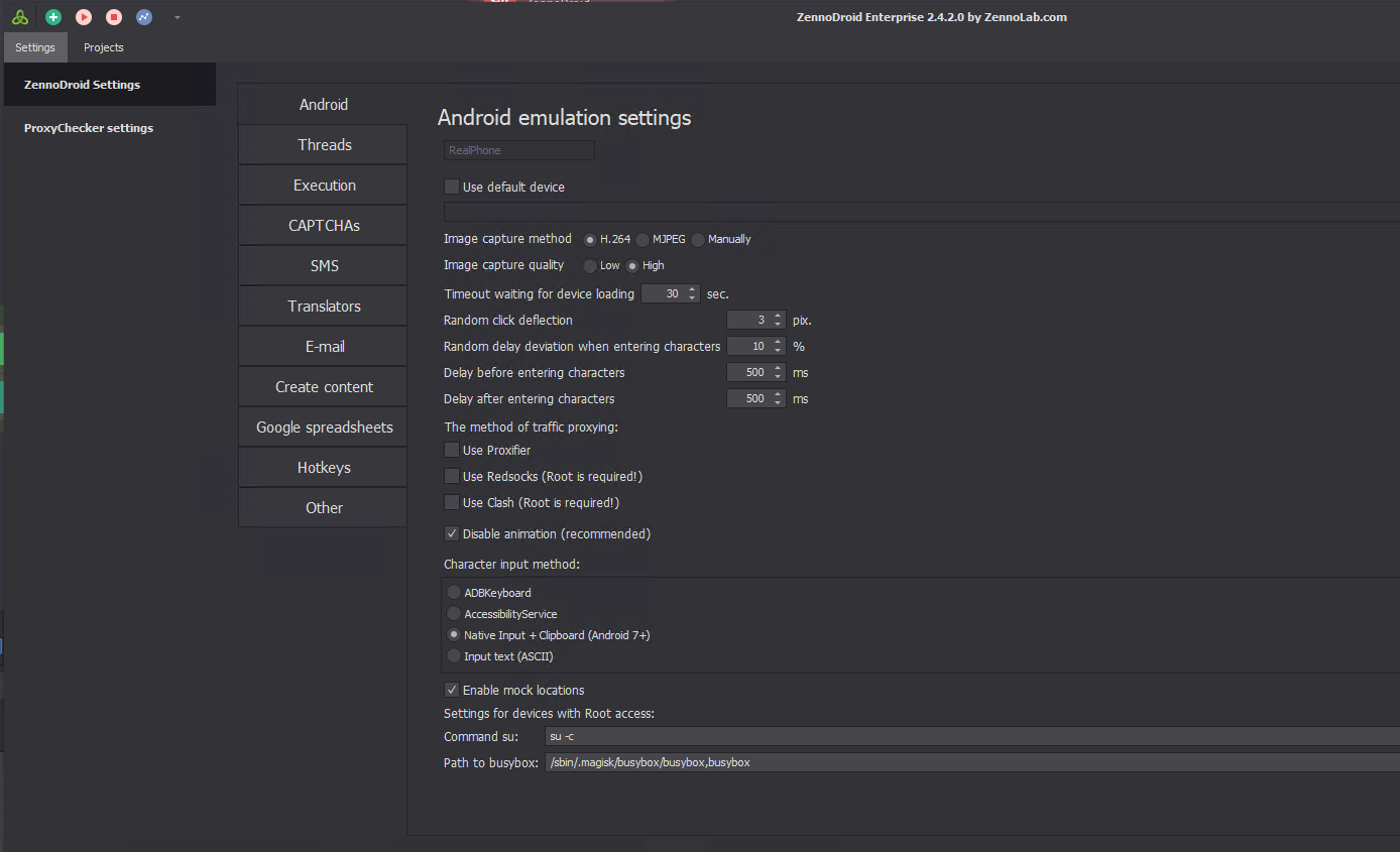

1. I have set proxy in the project, but when I put the project on ZennoDroid EN to run all the settings for proxy in the Maker project are disabled. The project will run according to the settings of Zennodroid EN.

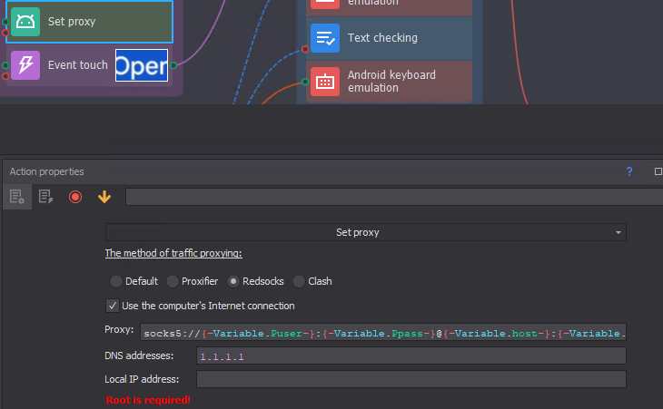

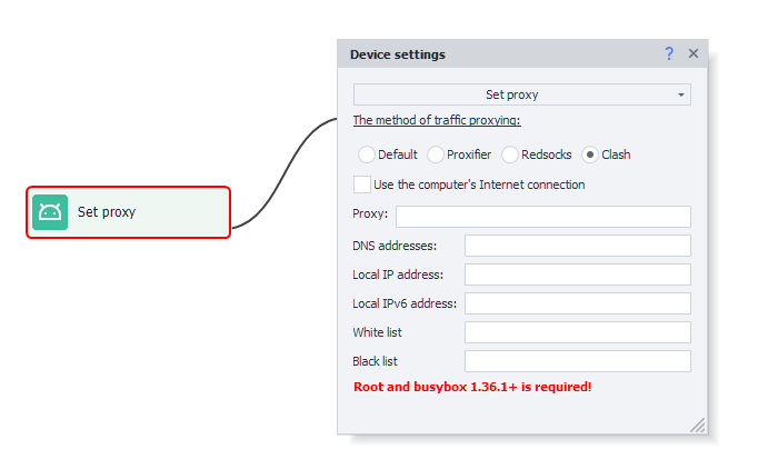

It is already possible to select connection method in Set proxy cube settings in version 2.4.2.0. Does not it work for you?
134834

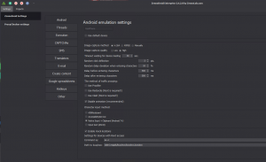

no. because when the project is uploaded to ZDE, the project will use proxy according to ZDE setting
    53,1 KB · Просмотры: 133
means i set in cube. then remove all options on ZDE

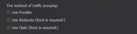

Example:
Case 1: I use redsocks in Project maker but when I select 1 of 3 options in ZDE it will follow ZDE. no control from project.
Case 2: I use redsocks in Project maker but when I don't enable any option in ZDE it won't fake proxy (Inactive)
See illustration!
    50 KB · Просмотры: 149
    193,5 KB · Просмотры: 141
Example:
See illustration!

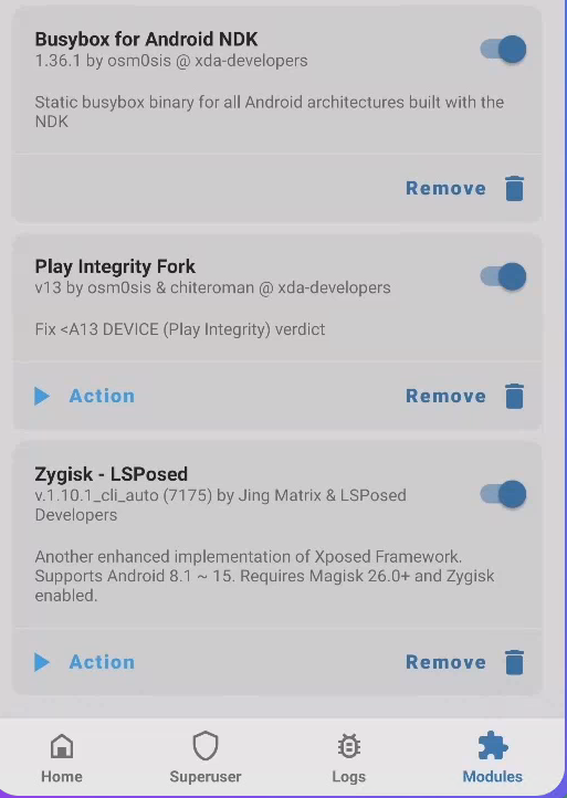

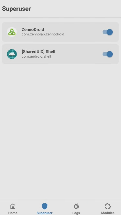

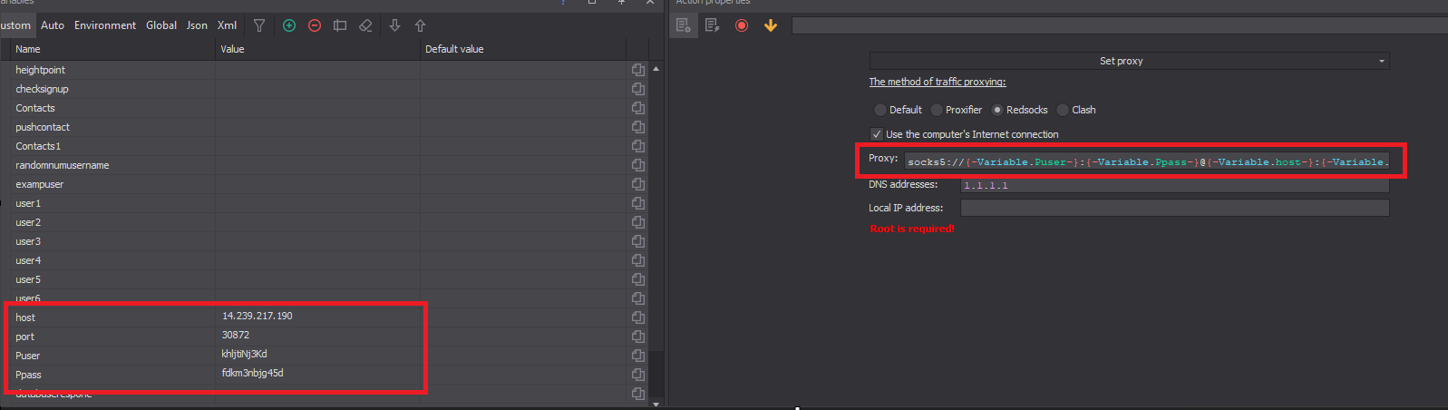

It seems that something was incorrectly applied.
Make you sure all variables have values.

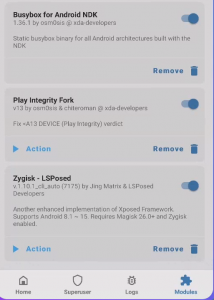

Do you have root access to the device as required?
Everything is normal!
All variables are fine. It still fakes proxy according to ZDE settings then all variables definitely have values.

all variables have values!
I have checked it thoroughly. The only problem is that the Set proxy option in Project Maker will not apply to ZDE. On the contrary, ZDE has full control over the connection options.

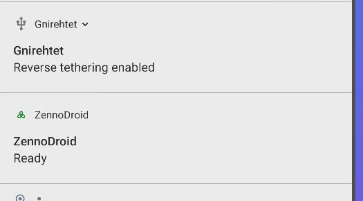

How do you check what proxy was actually applied?
And could you tell what device do you connect to ZDE?
- I let ZDE run a very simple project: Load URL to browserleaks.com/ip
- Select device name
Real phone!
I have been using ZDE for 4 months. There are many problems, this one is the most difficult. Please don't treat me like a newbie.
1. As I said, it totally works but only optionally in ZDE:
134908
2. But when I don't select anything, I completely lose connection to the Internet. (I did not check this option because I was testing to see if the cube worked?)
134909
- In case of losing connection to the Internet because I turned off wifi and used the Computer's Internet Connection. (Setting in cube not ZDE)
- In case of case still connected to the Internet because I turned on wifi without using the Computer's Internet Connection. (Setting in cube not ZDE). But, The result is local IP (not fake)
Anyway the cube setting in project maker doesn't work with ZDE

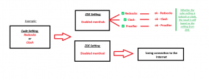

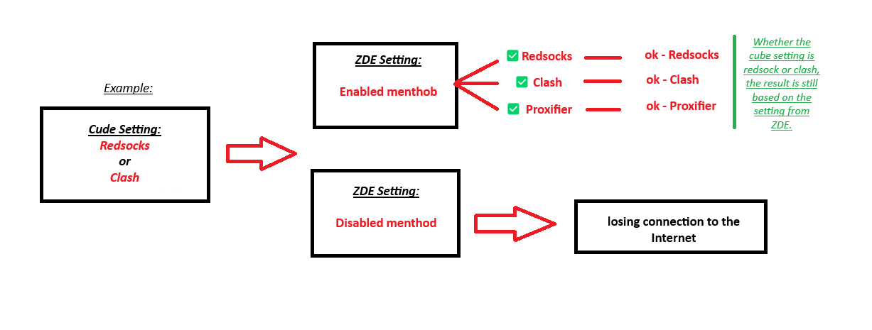

I drew a diagram for you to understand how ZDE is working.
    36 KB · Просмотры: 129
We tested it and could not reproduce the issue.
By our tests, proxy is controlled from the cube in version 2.4.2.0.
I'm kindly asking you to record the video demonstrating the issue and send it to us.
Thanks for your feedback. I will check it again carefully.
