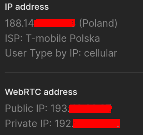

Hi,
been using mobile proxy for my projects and yesterday decided to take ZennoDroid for a test. I've set up the Memu Android 9 VM and set proxy to the ones I use in ZP. Unfortunately I don't see WebRTC emulation in Android settings and there's the problem.
Pixelscan shows my Public IP as not the same as mobile proxy IP. How do I stop the WebRTC leak?
When I tried disabling Proxified and enabled RedSocks with default settings I keep getting "Executing action Change device proxyof Can't check rules".
This leak makes ZD pretty much useless for me since every website I want to use with it has some kind of security measures...

Hi,

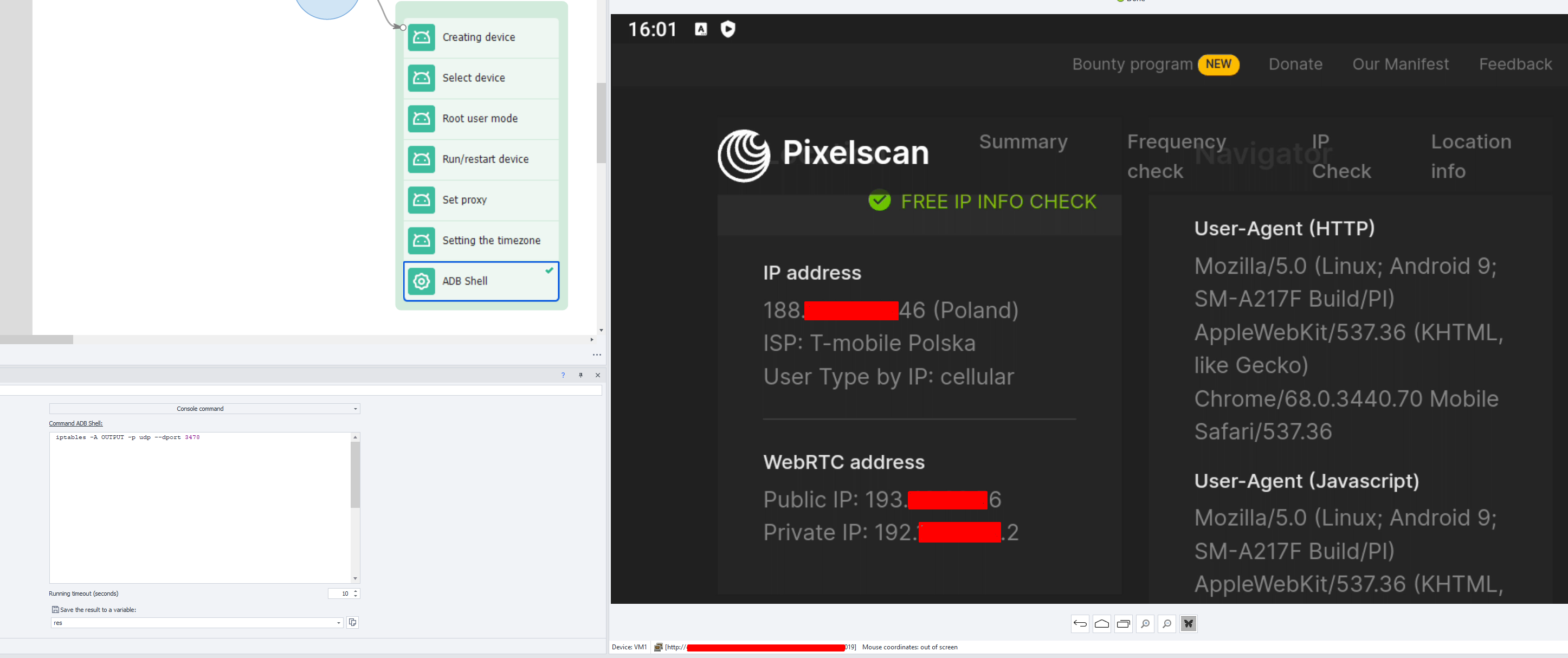

Or there is another way to block webrtc leak.
You should execute this adb command after installing proxy.
iptables -A OUTPUT -p udp --dport 3478

@VladZen do those two methods work with Memu and with domain:port proxies? I've tested the 2nd method and Pixelscan still shows that my public IP leaked.

@VladZen Yes, it was performed on a new VM and I made sure Chrome was not running before. Here's a screenshot:
