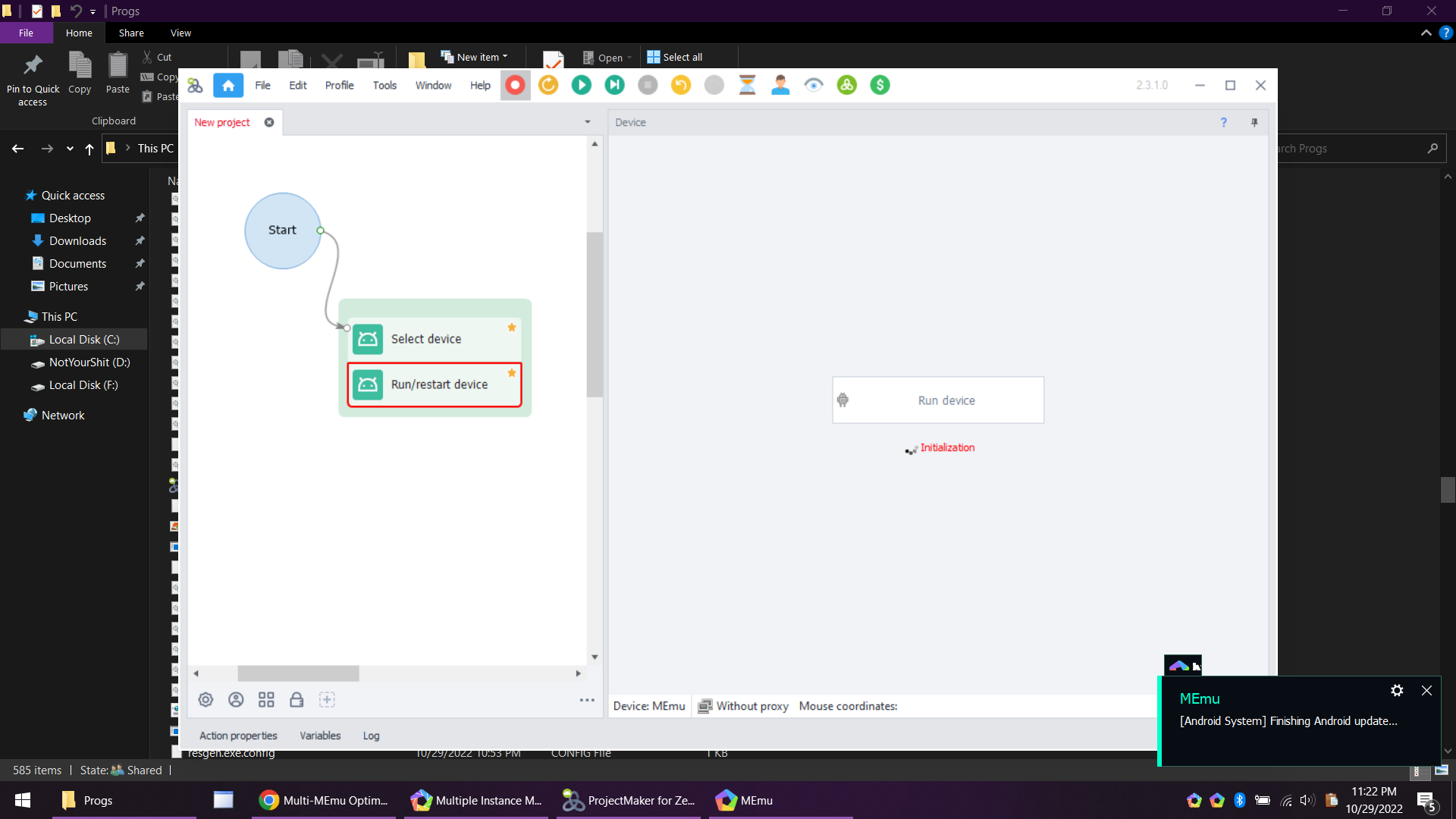

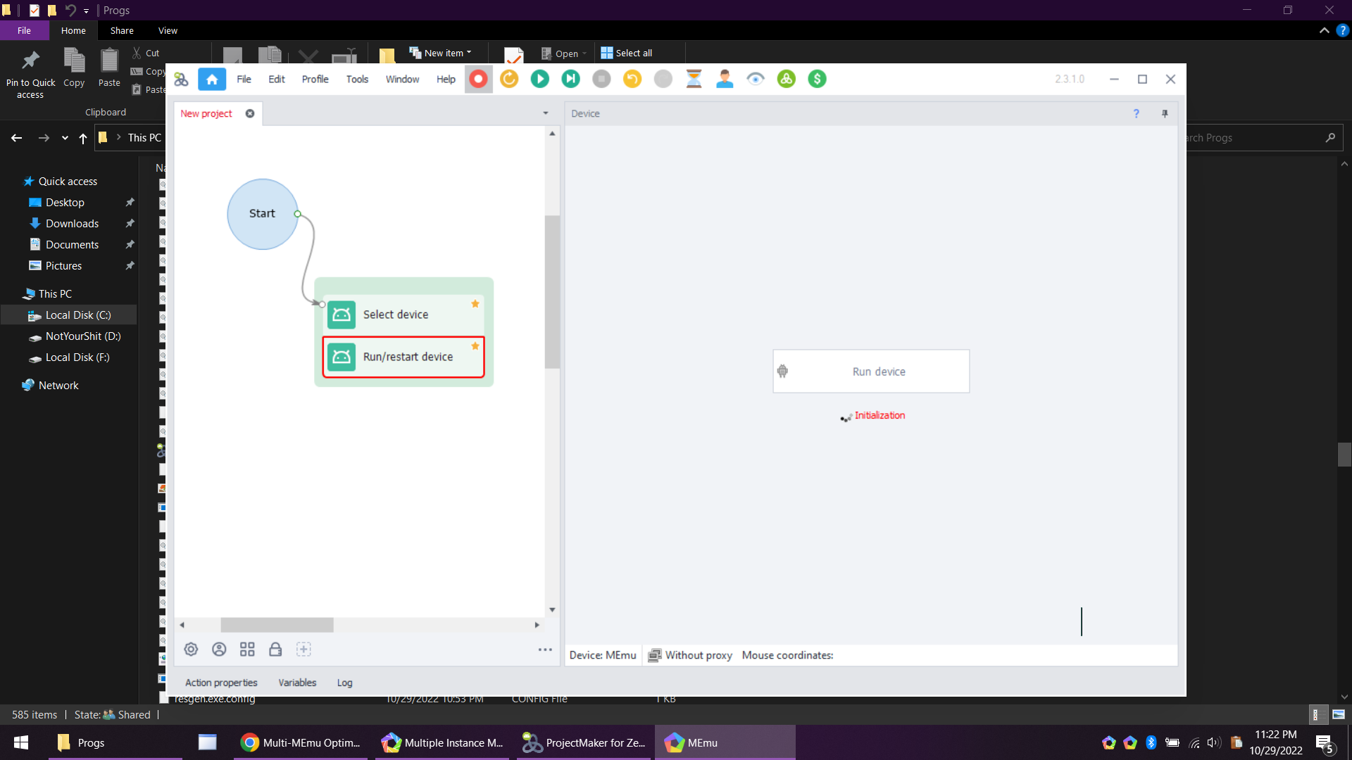

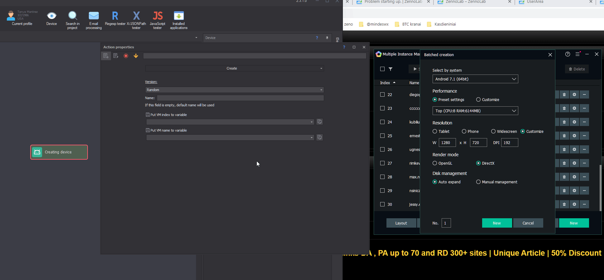

Im running the demo version of ZennoDroid 2.3.1.0.
Im running Memu 8.0.6.
After fresh install of both I startup project maker and click on "Run Device"
It says "Initialiing" below the "Run Device" button. It proceed to open Memu up but it usually starts so minimized that its just a single line on the screen about an inch or 2 tall. Then after a few seconds it gets a little bigger and turns into the box in the bottom right of the screen as shown in the picture. I can manually stretch the window to make it bigger but the Project Make never stops saying initializing. Then after about 30 to 45 seconds, Memu will just exit out and project maker says it failed.
I can open up Memu regularly without any problems at all. It starts up normal with the screen expanded the way it should be, and everything works on it perfectly fine. Also Memu's multiple instance manager works fine. When project maker does crash the multiple instance manager doesnt exit or crash. It stays running in the background with no issues.
I went ahead and attached a diagnostics along with the post if that might help at all.
Ive tried reinstalling ZennoDroid and Memu to no success. And I am running Windows 10.
Thanks for any help.

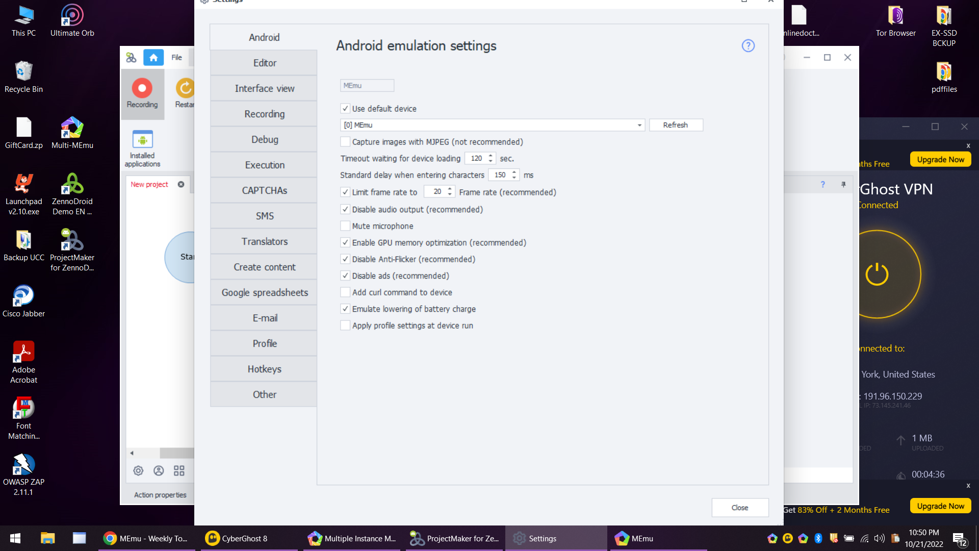

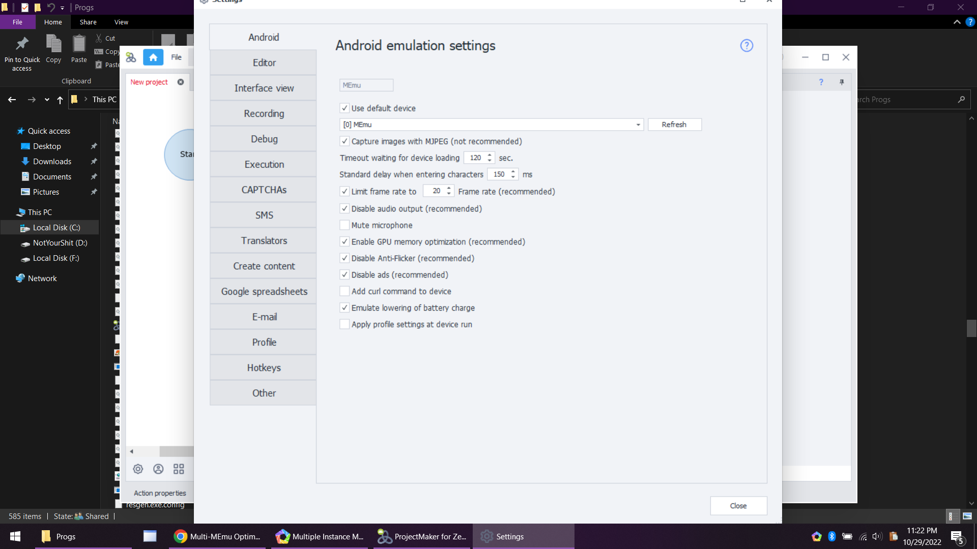

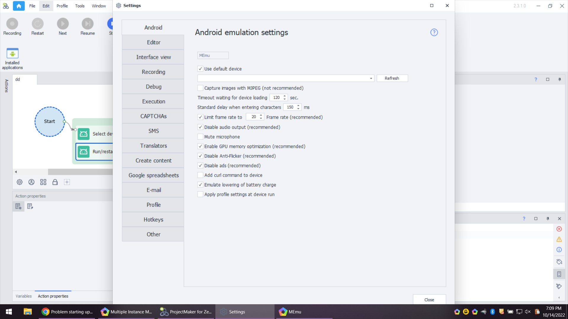

Could you please also attach the screenshot of program settings>Android Emulation settings?
DopedUp666
05.12.2021
DopedUp666
05.12.2021
after i try starting the image through project maker i go back through the multiple instance manager and check the settings and noticed that it drops my framerate down to 20
DopedUp666
05.12.2021
and activates gpu memory optimization but if i create the image through the manager and start it, it starts fine with my fps at 60 and gpu opt off. it only stops working after trying to use project maker to open it. then i have to delete it and recreate a new image to get it working again

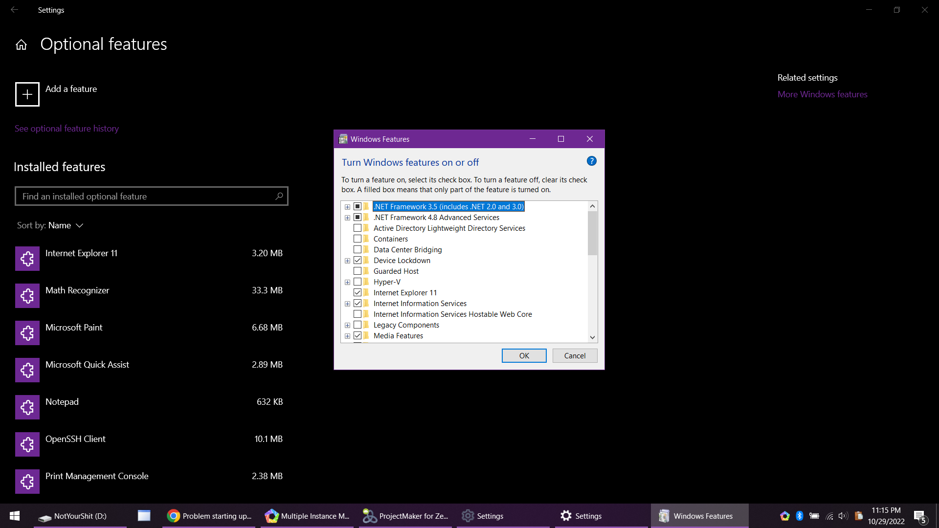

98698
i turned off hyper-V
selected default device.
same problem.
its starting up minimized

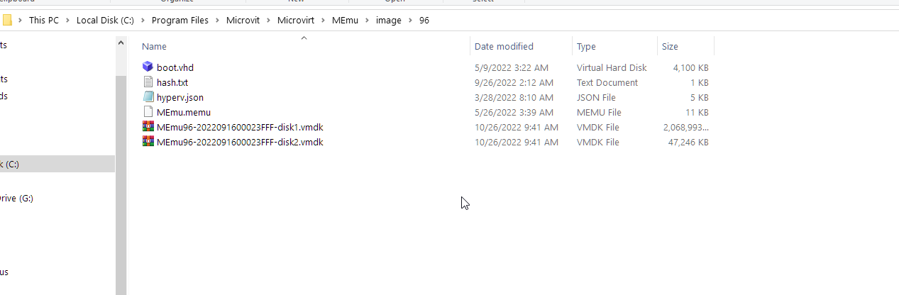

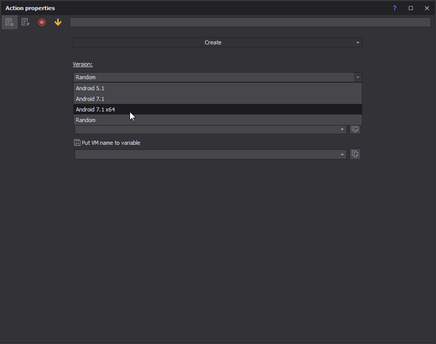

Installed the newest memu ( 8.0.8 ) and restarted the PC, android 9 still does not appear as an option. I guess will try to reinstall the ZD now )
Re-installed ZD 2.3.1.0 but android 9 still is not an option, strange )
99272
22 827
6 039
myndeswx
15.05.2017
437
104
Not sure where to do that? But if I am able to create and run android 9 in memu wouldn't that mean it is downloaded?
99273
Edit - downloaded the latest android 9 image I could find for memu and replaced it in /memu/image/96 folder, PM still does not pick it up
99274
